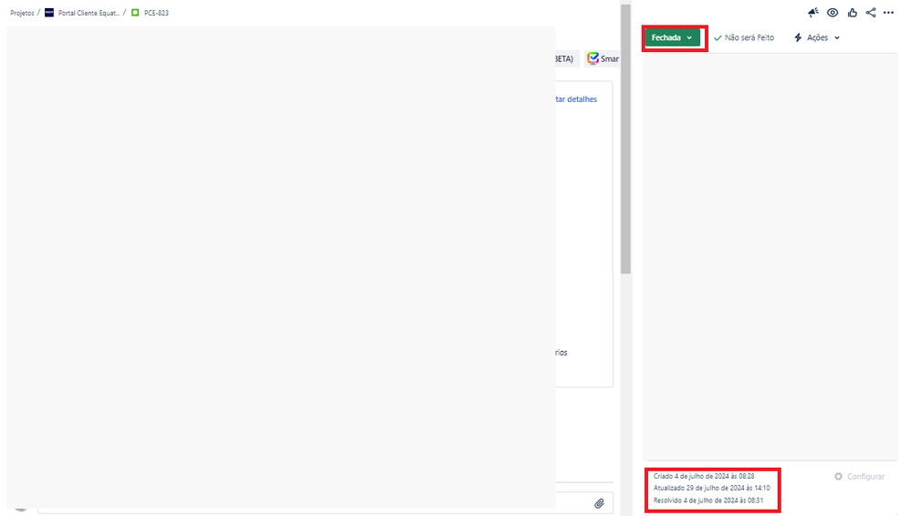

Here is the first evidence of the resolution on cards in red:
01
02
I found a difference between the cards. Even with a resolved status, in Jira, and the other as closed. Apparently, this is what is impacting the graph. Do we know how to fix it?

Hello @Jhomilton Silva
PCE-944 is missing from the results because the Resolved (resolutiondate) field is not set.
That field is set when the Resolution field is set.
You can tell if the Resolution field is set by looking next to the Status button. The value of the field will be displayed next to the Status button as seen here.
You can see for PCE-944 there is not value displayed, which indicates the field has not been set.
To Jira, that means the issue is unresolved, regardless of the Status assigned.
The field should be getting set during the transition to any Status that is color coded green (indicating a "done" status), and it should be cleared on any transition that can go from a green status to a non-green status.
Are these issues in a Team Managed project or a Company Managed project? I'm guessing that the issues are in a Company Managed project, because in a Team Managed project setting the Resolution field is usually handled automatically by Jira, without any intervention by users or custom configuration by administrators.
Fixing this is going to require assistance from a Jira Administrator in the case of a Company Managed project. The Workflow needs to be modified, and usually that can be done only by Jira Administrators.

Looking at the two issue images I can see that they are assigned different Status values; Resolvido and Fechada. The Resolvido status does not have the Resolution set.
Can you find any issues of the same issue type in the same project where the Status is Resolvido and Resolution has been set?
project=PCE and issueType = "Insert Issue Type Here" and status=Resolvido and Resolution is not Empty
If there are issues in the Resolvido status where the Resolution is set, you can examine the dates when those transitions occurred and look at what the status was before it transitioned to Resolvido. It is possible that the workflow transition to Resolvido was changed around that time, or the Resolution was set during the transition the issue was in prior to being set to Resolvido.
To fix the problem going forward you need to look in the workflow for the issue type(s) where the status is green/Resolvido and there is no value for Resolution.
You need to examine all the transitions to the Resolvido status and check the Post Functions for those transitions. They need to have a Post Function for setting the Resolution field. Here is an example of the Post Functions screen using the original Workflow Editor.
Making the change to add that Post Function will not set the Resolution for issuess that are currently in that status. You can move the issues through a series of transitions and back to Resolvido to update the Resolution after fixing the workflow. That will show the issues as Resolved on the current date.
