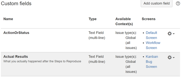

Actual Results custom field:

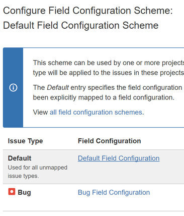

Only a single field configuration scheme:
Default configuration scheme:

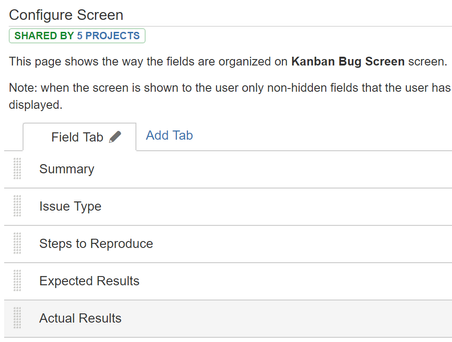

Bug screen configuration:

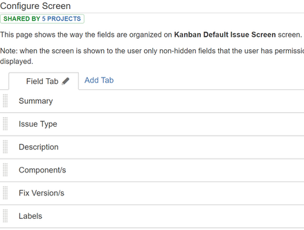

Default screen configuration:

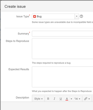

Create Issue screen:
Note that Actual Results is hidden, and Steps to Reproduce and Expected Results are not required.

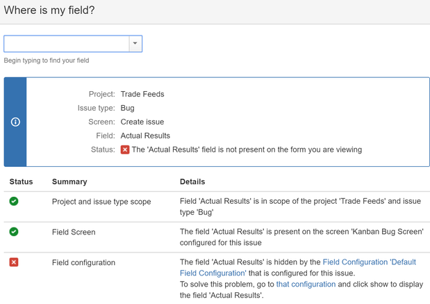

Where's My Field?:

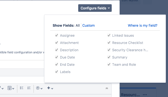

- when you're in the isre 'configure fields' is set to all (attached screen shot)
And yes agree with @Tarun Sapra suggestion below about the 'where is my field feature - you should also click on that.
I can confirm everything you asked is set up correctly, except the field configuration's association with the project. You can see in my second screenshot that I only have a single Field Configuration Scheme, and it has no projects listed under it. It looked to me like that meant it applied to all projects. Is that not the case?
Hi @Dov Frankel
If I'm reading your screen shot correctly that looks like the list of field configurations you have setup on your Jira instance.
What you then have to do is associate that field configuration with the Jira project or specify an issue type association.
This should help: https://confluence.atlassian.com/adminjiracloud/configuring-a-field-configuration-scheme-844500805.html?_ga=2.51414633.1901907075.1509353518-204997263.1500891987
Let us know how you get on.
Beejal
That's it! My projects are all associated with "System Default Field Configuration", rather than the only one listed, which is the similarly named "Default Field Configuration Scheme". Switching them over fixed that. Thanks!

JIRA provides good information about why some fields are missing. You can always runt hat check. On the create screen pop-up on the top right there is an option of "Configure fields" you can click on that option and then click on the link "Where is my field?" and then enter the name of the missing field and JIRA will automatically provide you with the right answer as to why the field is not appearing on the screen.
Thanks, I did try that. I updated my question with the screenshot of it at the bottom. Is it normal that it doesn't refer to the "Default Field Configuration" instead of the "Bug Field Configuration"?
It does look like that's the problem, but I can't figure out why it's not using the Bug Field Configuration I set up.
