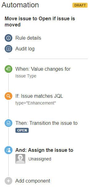

Thanks for your reply. I have tried renaming the statuses but to standardize things we'd like to keep the basic status names. I have also created transitions back to open (only visable and executable by administrators via validators) but when running the automation it does not transition the issue back to Open status. It is possible that my syntax is incorrect.

can you share your automation. screenshot would be great.
Draft automation isn't enabled I think? Also you need to make sure that the user that Automation is working as has permission to make the transition. Verify that this isn't the issue by removing your validator during your test.
In addition to @Boris Berenberg - Atlas Authority input which is very probable....
i use cloud so this is a bit different I don't have "type" everything is issuetype. however, I am wondering about the WHEN and IF here. I am suspicious that the IF is not triggering. I assume that "issuetype" is not an option for the IF? Conversely, "Type" is not available for When?
With server you can you view automation logs to run a test and see where it is falling out?

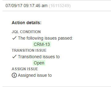

Ok so I tested with no permission conditions on the transition back to Open and automation ran successfully.
Because we don't want to have the Open transition available to all users. I added Automation for JIRA to the Administrators group and reapplied the permission on the Open transition and ran the automation again. It was successful.
I'm going to play around with this a bit to make sure it is solid but thank you so much for your assistance.
