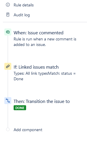

Using Automation I built you a rule the following - it is tested and works fine.
But this would need to switch to Automation.
The rule triggers on commenting your "main" issue and checks if ALL linked issues are in status "Done". If so, the "main" issue (the one which links all other issues) is transitioned to done, too.

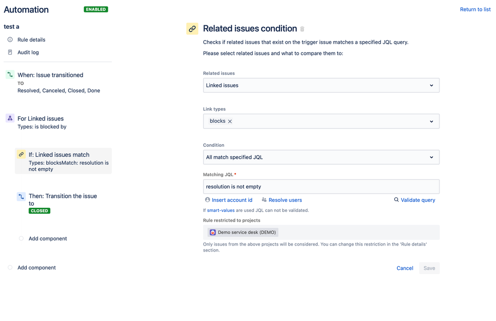

Alexis Robert
January 14, 2021
Hi @Berna Yavuz ,
this is possible with the Automation engine in Jira. You can create a rule that will trigger on a transition, check for the linked issue if all its other linked issues are also resolved, and then change its status. It might sound a bit complicated but you can see on the attached screeshot that it's quite simple :
Let me know if this helps,
