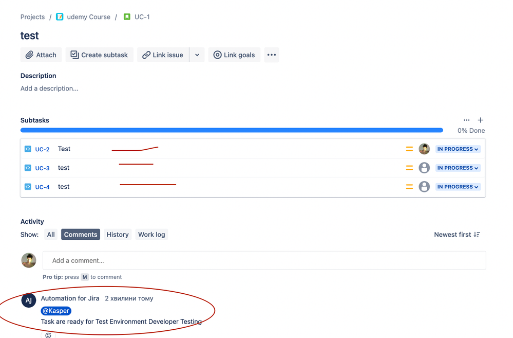

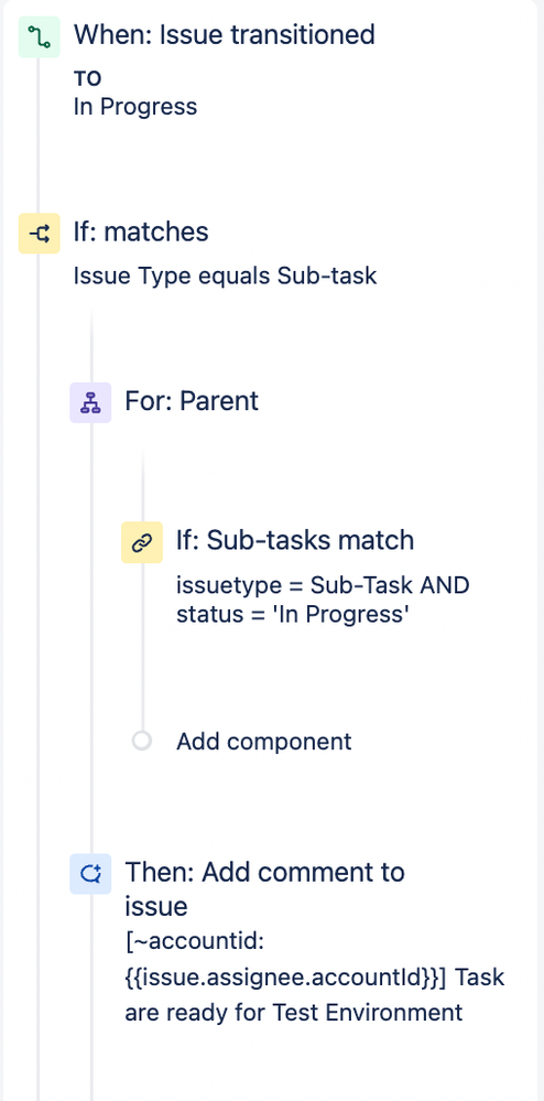

Additional screenshots of my automation rule and Jira board:
This rules works BUT, it's works each time when sub-task moved to status 'In progress'
I need to comment when ALL sub-tasks in the status 'In progress' thats a main case
need to solve.

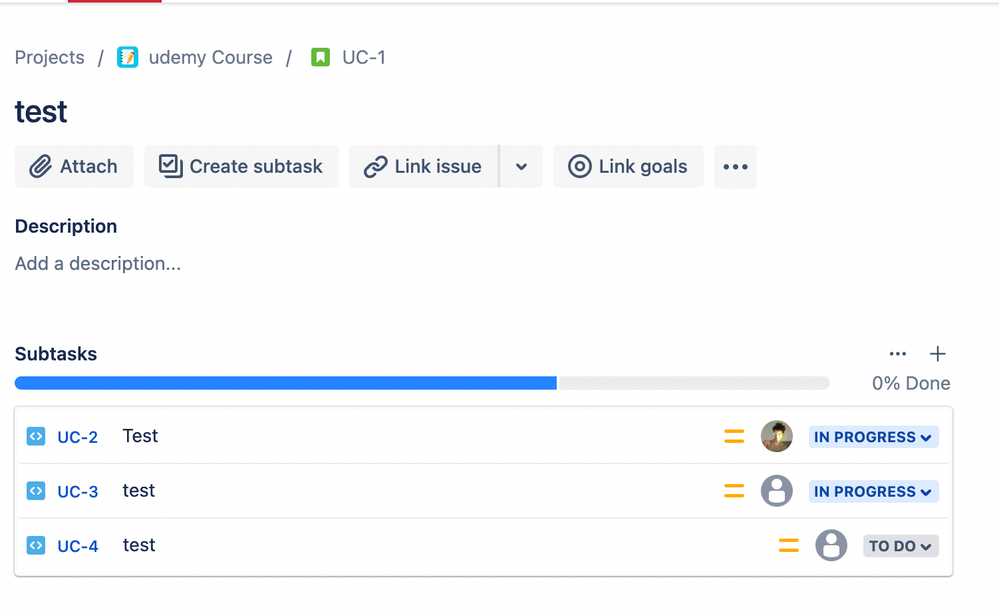

So as you can see i moved not all sub-issue but it's already commenting sub-tasks.
I don't know what filter i need to create or rule to explain Jira when it's need to comment.

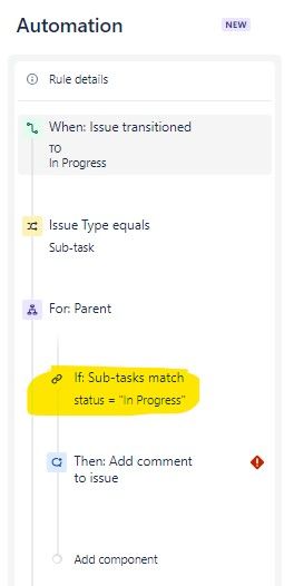

Moving on to your automation, there is problem in your automation configuration, it should look like below : The highlighted part uses the related issue condition rather than issue field which checks the condition All match specific jql. And then comment part should be under your if statement & not as separate component like you did which is at same level as branch rule level. This should work out.
