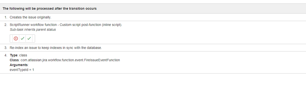

The script you posted showed errors when I entered it under Custom Script post-function. So, I've modified it to the below and it shows no errors on the script window.
if (issue.parentObject)
  issue.setStatus(issue.parentObject.getStatus())
But the sub-task still doesn't get the status of the parent though it shows a green tick whenever I add sub-tasks here. Pls see screenshot attached.Post function.pngError in script.png
David Fischer
March 20, 2018
This is not a JMWE Scripted (Groovy) post-function - this is a ScriptRunner post-function. This is why it doesn't work.

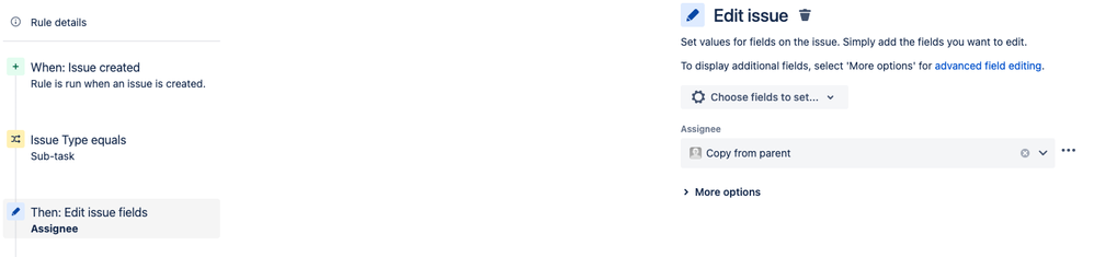

You could use an automation rule to do this [Note that I did this for a single company managed project and have not rolled it out globally, but theoretically it should work globally too].
Go to project settings > hit automation > make sure your in the project you want to test the rule in > on the right hand of the screen click the blue create rule button.
From there your going to create the following:
[Trigger] When an issue is created,
[Condition] If the issue type is a sub-task,
[New Action] Then: Edit issue fields "Assignee" (in this one make sure to choose copy from parent)
Hit Save. Then publish the rule.
This won't update previously created sub-tasks, but it will work for newly created ones.
Good Luck!

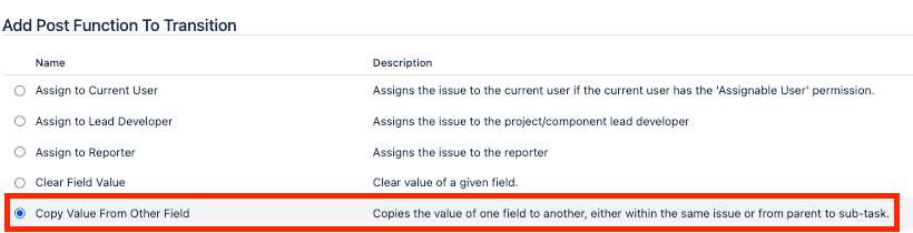

However, if your sub-tasks have a unique workflow then you can set a "post function" when a ticket is "opened" to copy the assignee from the parent. Note 2 things:
  1. Post Functions, currently, do not count against automation rules
  2. The reason the sub-task needs to have its own workflow is because if you do not, then I think the tasks/stories will adopt the assignee of the Epic (which may not be a terrible thing, in some cases).
How you would do this:

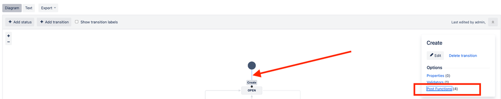

  • Set up your workflow for the sub-task
  • In the Workflow between the dark circle and the "open" status there should be an arrow. Select that and on the right, select "post function" (see image)
  • On the Post Function screen, on the right, add a post function
  • Then select the post function option "Copy Value From Other Field" (see image) and at the bottom left, press "add"
  • Then select (see image):
    • Assignee
    • Assignee
    • Copy from Parent
