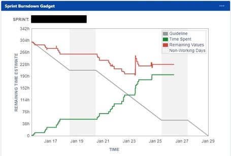

Bhuwanesh Man Rajbhandari January 25, 2020
I use the estimated time and logged time with the following gadgets and usage:
  • Using the WORKLOAD PIE gadget
    1. I create 2 different "Workload Pie" charts gadget on my personal dashboard.
    2. Chart 1 - Original Estimate by Assignee
    4. Chart 2 - Current Estimate by Assignee
    6. Compare separately on how much work was estimated vs work remaining.
  • Using the Sprint Burndown gadget
Like Sue Hannan likes this

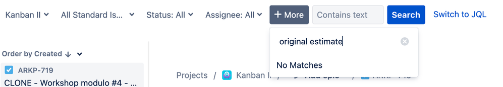

matteo maria ambrogi
January 17, 2022
Hello, I was trying to implement part of this solution but, it seems I cannot find anywhere Time spent and Original estimate field in the CREATE FILTER SECTION.
what am I doing wrong?
