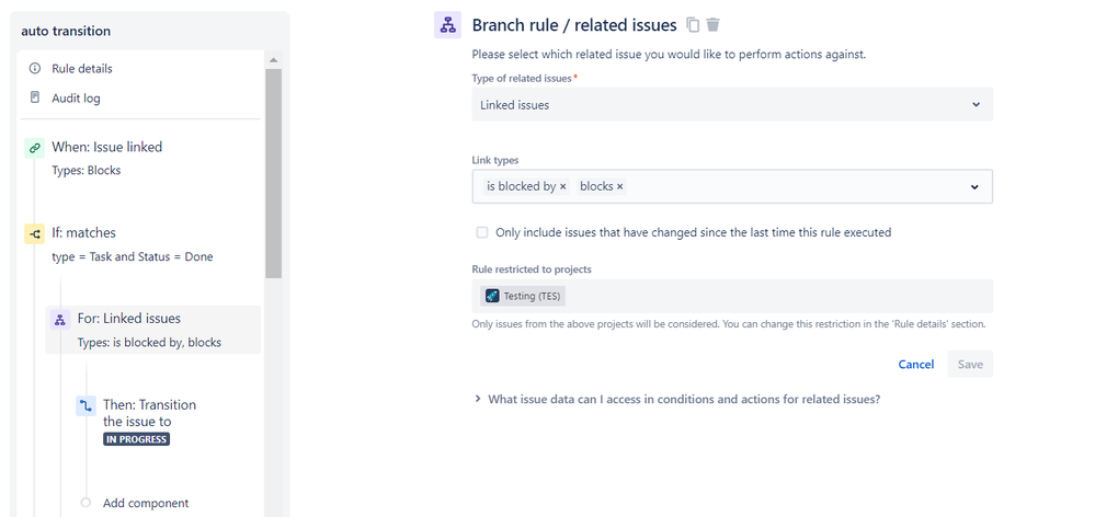

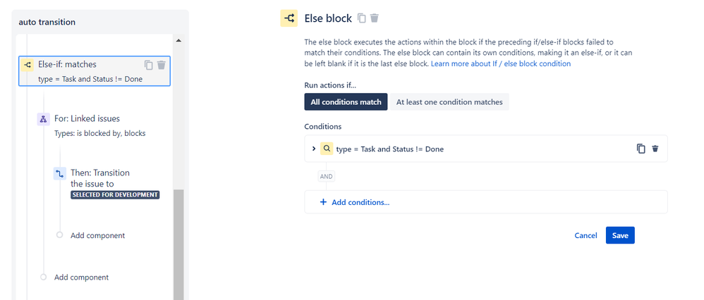

You need to create 2 rules, One on Issue linking and another on issue transition. Please use below rules to achieve your requirement.

Hi @Mohammed Aamer Khan ,
Thank you very much for your response, but I created two rules following the method you provided, yet they did not fulfill my requirements.
Upon reviewing the audit logs, I have discovered that neither of these rules were executed.

Rule 1 will execute when you link an issue.
Rule 2 will execute when you transition / Change status of issue.

I have noticed that if we simply change the "Linked issues types" in the "for branch" to "blocks", it will work. However, adding the "is blocked by" rule instead will result in unsuccessful execution. I appreciate your gratitude once again for the assistance provided.
