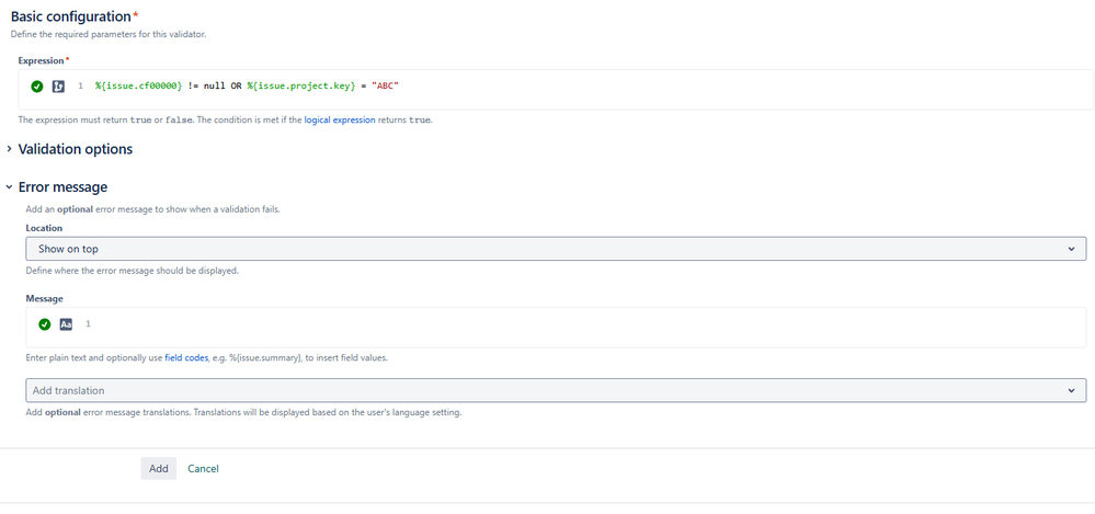

It sounds like you are referring to a "logical validator," which suggests that you might be using Jira Workflow Toolbox.
If that's the case, an expression like
%{issue.cf00000} != null OR %{issue.project.key} = "ABC"
should do the trick - using the correct custom field ID and project key, obviously.

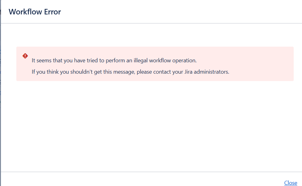

Hi Throrsten,
Thanks for helping in the logic, the logic is working fine, But i have one issue for other projects it was not displaying the field name , it was displaying just error message, how can i modify
Hey @keerthika Narra,
Have you checked the 'Error message' section at the bottom of the validator configuration?
Besides, if your initial problem is resolved, please don't forget to accept the answer.
Thorsten
@Thorsten Letschert _Decadis AG_
After posting the thread i got an idea, to update the message in Error tab, i did that and it was working fine.
Thanks for your support....!
Keerthika
