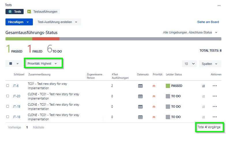

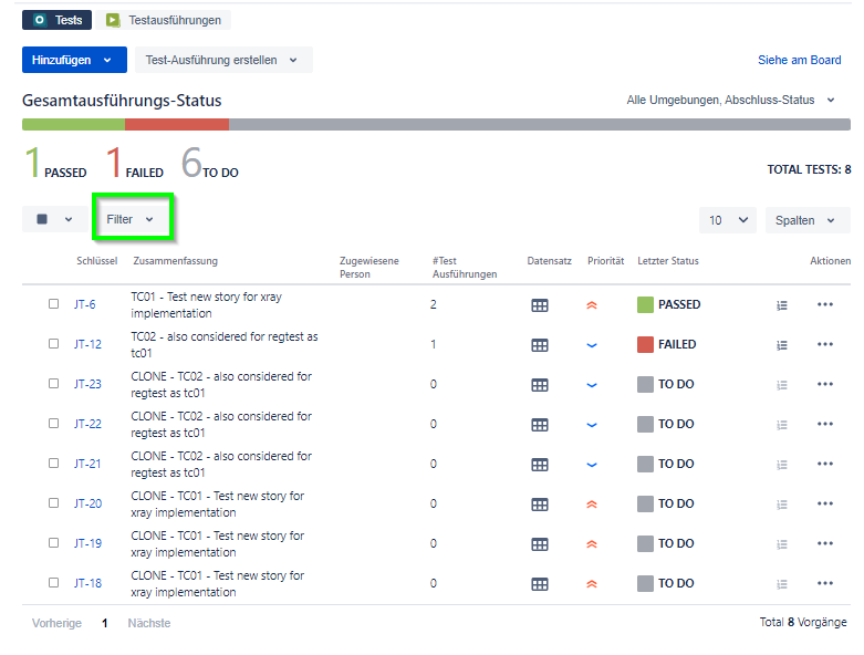

1. Filter within testplan
Within your testplan issue you can set a filter on your tests:
You can then filter your list of tests for one or several priorities. Out of the filtered list you can then create a new test execution. The newly created test execution will only contain the previously filtered and selected tests. (see screenshots, sorry for the German setting. If needed I can also provide them in English ;) ).
