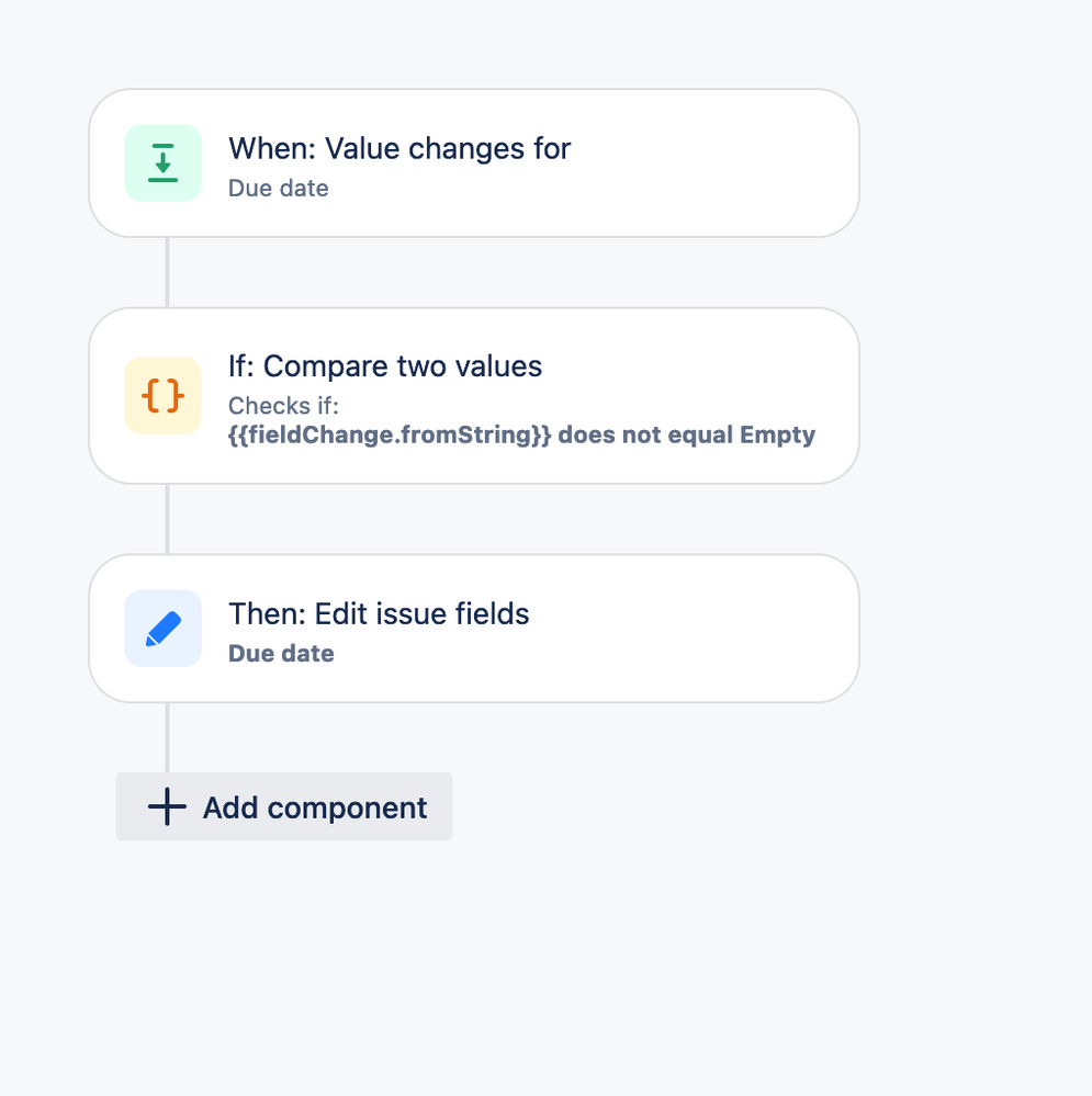

Hi Adrienne,
This is not directly possible at present if the field was not populated on create, but rather set later (or if your project is team-managed). However you can configure an automation rule so that the value is set back to the previous value. The automation rule below depicts how you would do that for the "Due Date" field as a sample.
In the last step, the new value for the field is again the smart value {{fieldChange.fromString}}
You can also add a comment to the ticket when this is done that mentions why the field value was set back (as another step in the rule).
For a company-managed project, if you remove the field from the edit screen, people will not be able to change it after it was populated on create.
