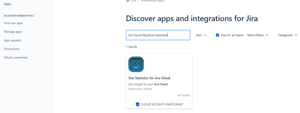

I would like to rehearsal for the migration first but seems I could not find JCMA in my trial version JIRA.Capture.PNG

Fabio Racobaldo [Catworkx]
May 30, 2023
Hey @anson.wu , you need to install that app on Server/DataCenter instace and not on cloud side

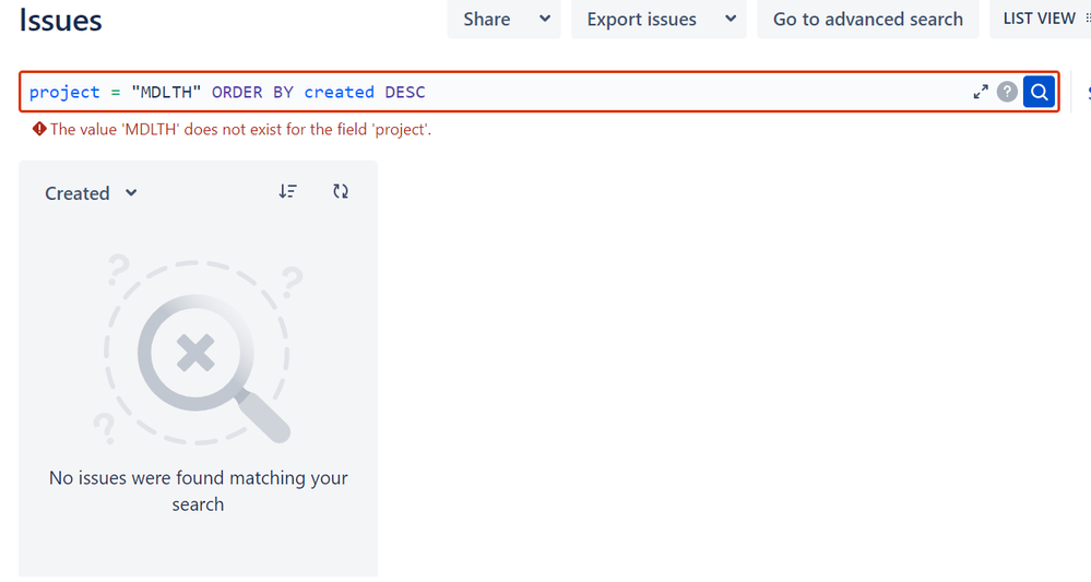

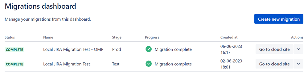

@Fabio Racobaldo [Catworkx] Thanks. Actually I successfully installed JCMA in my instance but encountered problem. I selected both [Test/Prod Migration] to migrate data/project from my instance to my free trial Cloud JIRA for rehearsal. It shows successfully migrated but I just could see an empty project in my Cloud JIRA(only same project name/key without any task/story migrated).
Would you pls also advise?
