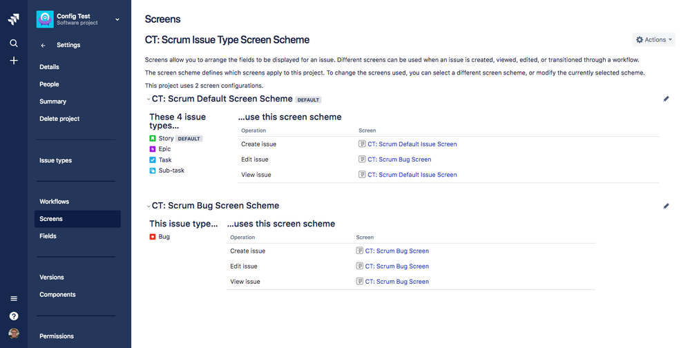

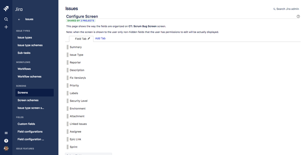

Step 1: Click on settings within the project (issue/board) you are in. Should be on the left-hand nav.
Step 2: Within project settings, click on the screens option from left hand nav. Here you can see the specific issue type scheme's applied for each issue type within this project.
Step 3: Let me know if the view and edit operations are using different screen configs (the default would have all 3 operations (create,view,edit) the same but they can be configured to be different).
Step 4: If you can see the field but cannot edit it, that leads me to believe the assignee is not on the edit screen config. Try adding it and see if you can edit the assignee field now.

Daniel Brown August 12, 2018
Ok so I see the issue.
This new view doesn't allow editing of assignee if its not added to the configuration. If its not added it still appears in the new view but doesn't allow changing of the assignee.
