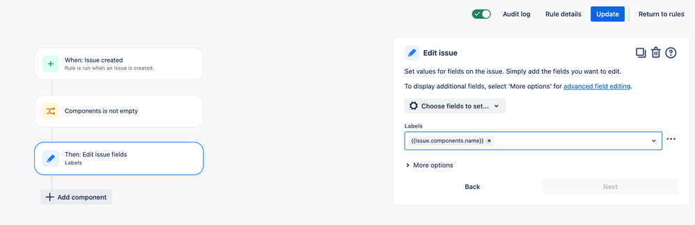

could you please confirm if you looking for something below

You can try something like this.
{{issue.components.name}}
