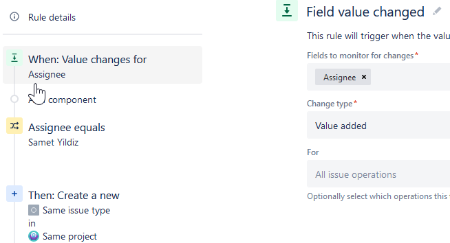

Samet Yildiz December 12, 2022 edited
Hello @Lorelai
there are severeal ways via automation... you could create an automation which looks like that and than customize as you like..
Regards
Samet
Lorelai December 12, 2022
The problem is I want to create the ticket based on adding the option to the custom field admin not when populating the value on the actual ticket.
