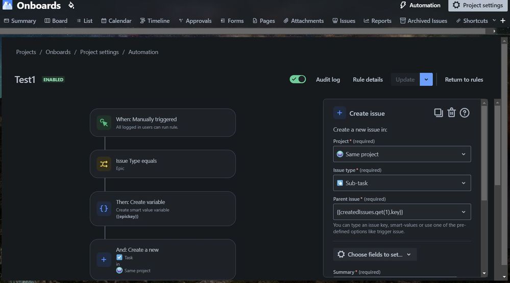

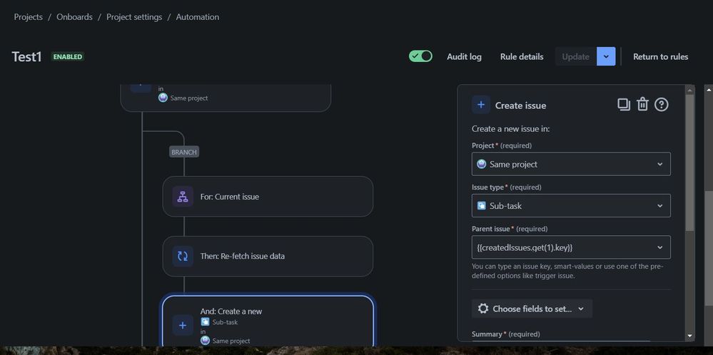

I'm trying to use Automation to create Epic>Task>Sub-Tasks and when I run the rule I only see the Epic>Task issues create. See screenshots as to how I set it up based on this thread but the Sub-tasks won't create. Please help! What am I doing wrong?

After you create the new Task, branch to the Most Recently Created Issue rather than to the Current issue. Then the subtasks will be added with the new Task as their parent.

@Bill Sheboy Thank you for the suggestion, and I made that update, but the sub-tasks issues are not still generating. Could there be some wrong with the Re-fetch Issue data condition or perhaps the value I have in the parent issue field for the sub-tasks?
Reading your original rule images, I notice some things that would cause problems:
Lists use a 0-based index in rules, and so the parameter to the get() should be a 0 and not a 1. However, that is not needed when the branch is changed.
Assuming you are trying to add the issues and tasks under the trigger issue, please try this one:
Once the rule is inside the branch, {{issue}} refers to that issue and so the {{createdIssues}} smart value is not needed.
If instead you are also trying to copy the trigger issue, please let me know.
@Bill Sheboy This was very helpful. I ended up removing the manual trigger and replacing it with a status change trigger. But using issue.key worked like a charm, and so did using most recently created issue. It seems to be working well. I really appreciate your help on this!
