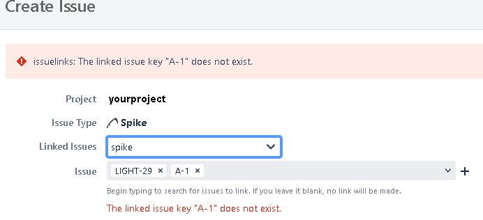

Interestingly enough, when I pass an INVALID issue key, it adds it to the list box and then complains that the issue key does not exist:
<base-url>/secure/CreateIssueDetails!init.jspa?pid=10101&issuetype=1&summary=hello&reporter=<reporter>&issuelinks-issues=yo&issuelinks-linktype=blocks
Generating this error:
So obviously I have the right query parameters!

CreateIssueDetails!init.jspa?pid=12345&issuelinks-linktype=relates+to&issuelinks-issues=${issue.key}&issuelinks-issues=A-1 ...
I put in the first issueKey i want, then I add another issuelinks-issues= with a bogus issue to make the field populate
this does cause the error to fire, but at least the real issue does get put in place as well.
