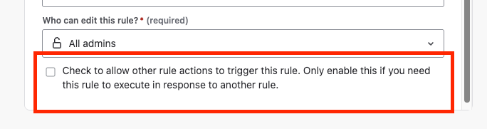

On the Rule Details page is a check box that needs to be checked to allow an Automation Rule to be triggered based on actions taken in another Automation Rule. By default this box is not checked. I suspect that is the root cause of your problem.

Quinn Campbell
July 2, 2025
That was it! I knew it was going to be something small and silly. Appreciate the help!

Hi @Quinn Campbell
Without seeing the specifics of your rules / audit log details...
By default, the actions of one rule will not trigger other rules.  This prevents mistakes and runaway rule looping.  When you intentionally want a rule to trigger based on the actions of other rules, in the downstream rule, enable this option in the rule details at the top:
Check to allow other rule actions to trigger this rule. Only enable this if you need this rule to execute in response to another rule.
Bill
