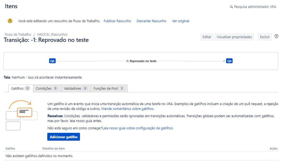

The -1 is leading back to the same status - this is not at all wrong. But I guess there is a post function implemented in the workflow, that will decrease something. Can you click in detailed view of the workflow on the transition #121 and post a screenshot?
so long
Thomas

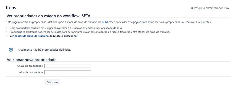

Joyce Costa January 31, 2018
Dear @Thomas Deiler,
Thomas Deiler
January 31, 2018
Ok, thanks - doesn't look like there is an additional post function - there are 5 and that's the default value (normally).

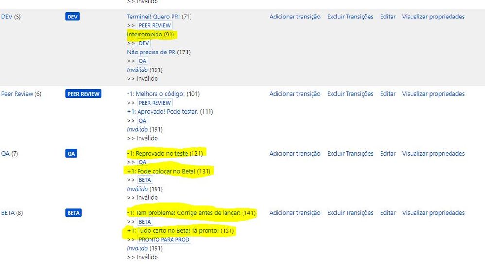

I also want to know how to generate report on the rotation of actions to reject the test of development (-1) minus one. This step is within the workflow of QA, Beta, Ready for Prod.
So I don't get the very details of this quoted text - sounds like some google translate result. Can you please explain in other words what you would like to do?
so long
Thomas

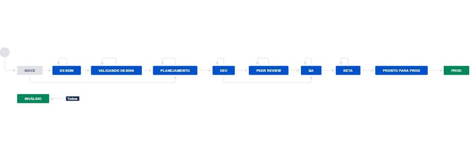

@Thomas Deiler,
First problem - It's correct, when pressed the "paused" button nothing happens! Yes! I want to know how I can extract report of problems in the "paused" status in my project
Second problem follows screen capture of workflow
