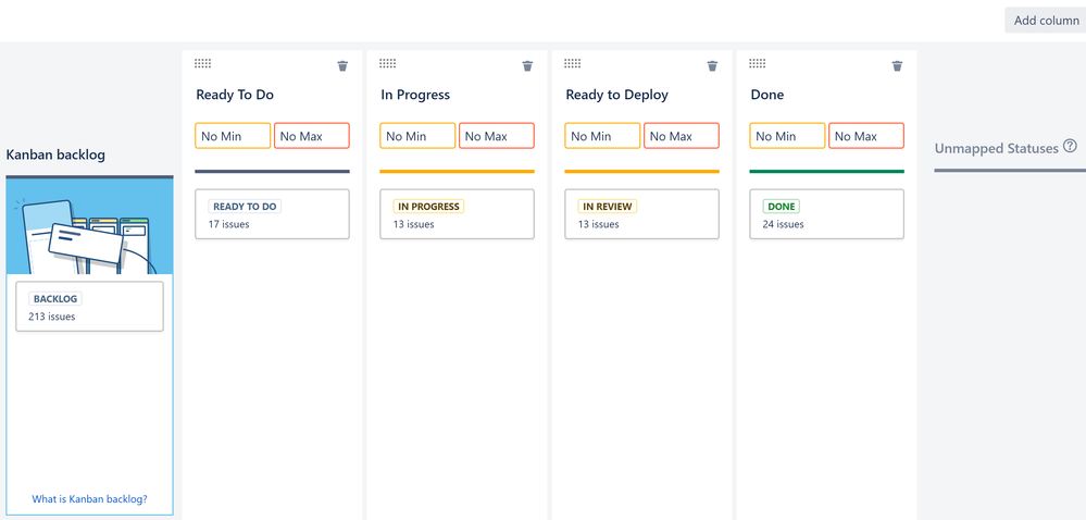

@Amy Cate you just drag the statuses into the columns. Let me know if that works.

P.S. There is an 'Add Column' option, you can always add more columns. Any Unmapped Statuses are shown under 'Unmapped Statuses"
