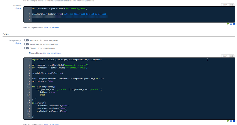

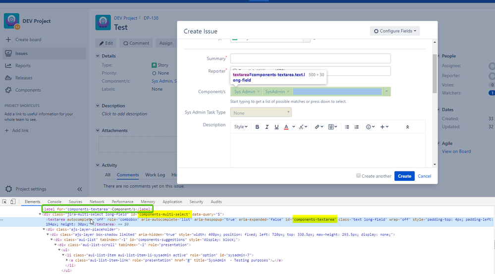

Hey Leo, thanks for taking the time to reach out... I've implemented the code example you suggested and I'm not getting any errors but I am also not getting any results. I have the code executing as a server-side script. I am expecting the issue to attempt submission, but fail because I have set the "sysAdminCF" field as required. Is the logic incorrect?
Also, I'm not sure if I am using the correct component id as there are multiple id's within the man Div.2019-12-10_11-11-38.png 2019-12-10_11-27-54.png

I'm not sure whether "components-textarea" is the correct one or not
you can use
def component = getFieldById(fieldChanged)
Like • Alex Sorikov likes this
Terrell December 10, 2019
Ahh yes! I wasn't sure if "fieldChanged" was just used as a placeholder for the id of the component field or what. That explains why I wasn't getting any results. Thanks for your help, it works like a charm!
