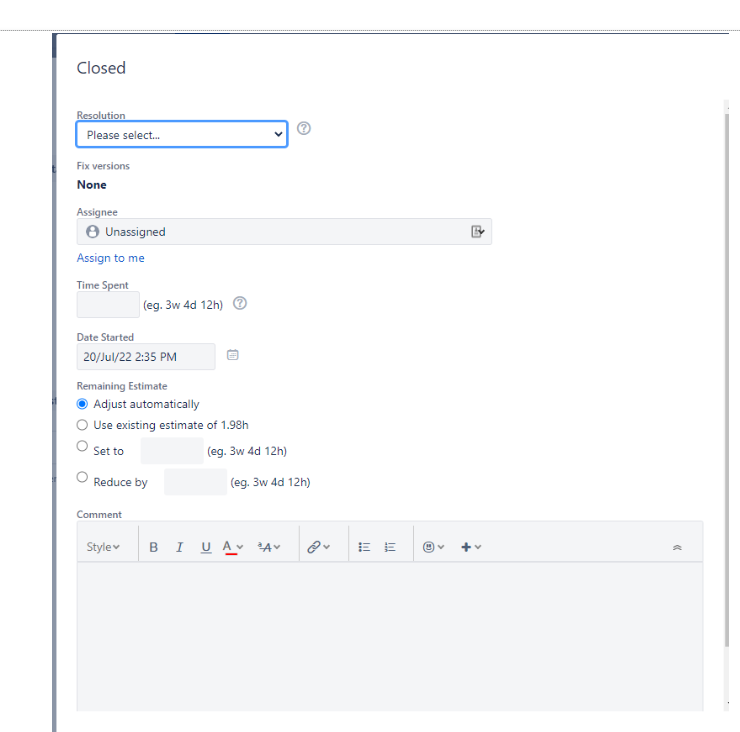

When I transition an issue to "Closed", project A opens up a screen titled "Closed" (see below) offering me a range of reasons why the issue was closed ("won´t do", "Duplicate", "hardware failure"etc.).
Project B simply transitions the issue to closed WITHOUT opening up this screen.
For us, it is important to know why an issue was closed for later follow up, and therefore we want the screen "Closed" with the options to select from displayed every time we transition an issue to closed.

The workflows are different. The one not opening the transition window has a post function setting the resolution field. You need delete the post function and use a transition window showing the resolution field
Please check the transition screen leading you to the closed status. make sure you have selected the correct transition screen that has Resolution field on it.

I was able to solve my problem now based on your recommendations!
... Very releaved and happy! :-)
