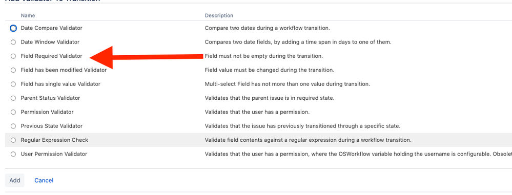

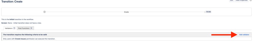

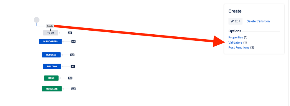

For a Company Managed project you could edit the Create transition in the worrkflow to include a Validator to require the fields to be filled in.

I'll try your instructions above, thank you!
