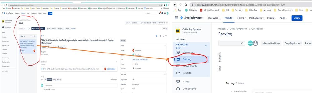

This does not need to be automated. The Sprint owner that has a list of issues in their sprint but not in their backlog . How do you move them within the Current sprint from their open issues into the sprint backlog or into the current sprint? There must be an easier way
It would be a two step process to move to the active sprint. You'd perform the move to get it into the other project and then that will make it appear at the bottom of the backlog. From there, someone would need to drag the issue into the sprint.
Tried that, Move works great to get it into the new Board, but it doesn't appear at the bottom of the backlog. It only appears in the issues and you have to click all open issues.
You may want to review the board filter to make sure it is inclusive.
