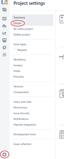

Try using its ID rather than its name (e.g. project = 10800). One way to find that value: go into the project's settings (cog icon in the lower left) and then hover over the Details link in the left sidebar.
