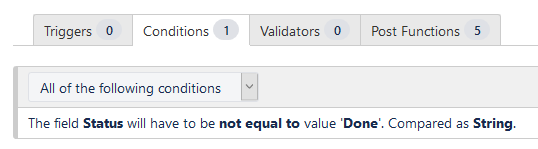

Thorsten Letschert _Decadis AG_
October 28, 2019
Hi @Marianne van Nouhuys ,
while the aforementioned suggestions are valid with regard to removing those all transitions in general, the best approach might as well be keeping this all transition and just adding a Value Field condition to this transition.
It always depends on the numbers, e.g. if you have 10 statuses and your transition should only occur at one status, go ahead and add a single transition. However, if you need your transition from 9 statuses (all but one), I'd use the all transition and add the condition for the single status where it's not needed.
I hope that helps.
Cheers
Thorsten

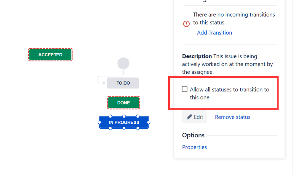

Haran Kumar
October 25, 2019
Edit your workflow and  can click on the  transition to close status. Noe you can deselect the check box of "Allow all statues to transition to this one" . Publish the draft workflow and you are done . Now you will not get close at all status transitions.
Hope this helped you
Regards
Haran
Ollie Guan
October 25, 2019
If you need to skip some steps, the easiest way is to select "Allow all statuses to transition to this one".
https://confluence.atlassian.com/adminjiracloud/working-with-workflows-776636540.html#Workingwithworkflows-workflowdesigner
