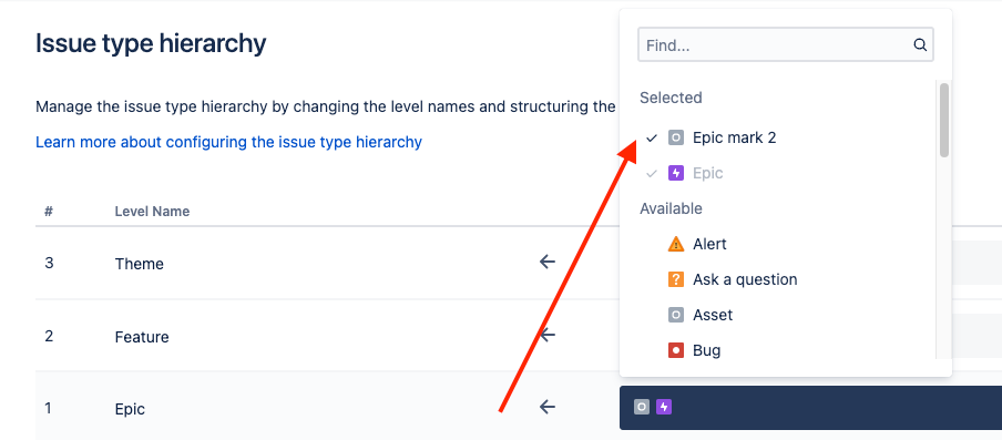

I have not worked much with AR and the extended Issue Hierarchy so I decided to test this out.
When I add a new issue type in the Issue Hierarchy at the same level as Epic, I am not able to then make that issue a child of the Epic issue type.

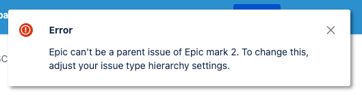

When I try to drag an Epic mark 2 type of issue into an Epic on a Backlog screen (for a Company Managed project), I get an error message and am not able to complete the task.

Actually, I am not able to add such an issue as a child of an Epic. If I select 'Add a Child Issue' when in an Epic I see the new Issue type in the dropdown list - suggesting I can add it as a child - the create screen appears but when I submit it nothing happens - it just hangs.
