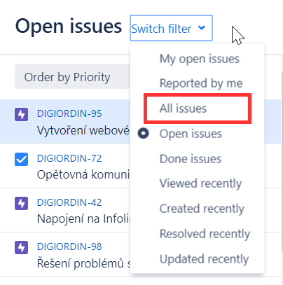

Hello @Angela Pingram
there is a predefined filter in JIRA to show exactly what you need. See below:

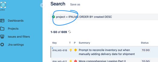

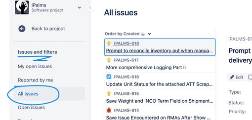

this does not happen for me on Cloud. Here is what i see. maybe you are navigating thru different screens? when you say you are "in the project" can you explain or provide your screenshots similar to mine below?
At the project level I click on All issues...
I then click on the Advance search and see this...
