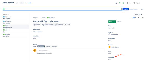

Per your description, I understand that the Story point field is not appearing in your issue navigator when open the issues in detail view (panel at the right side) and the field is empty. Is that correct?
I tested the behavior you mentioned in my personal site, however, the field display just fine in the detail view as "None" when it's empty, as you can see in the screenshot below:
Can you please confirm if that's the view you are talking about?

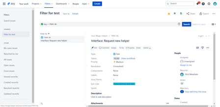

Here's a screenshot of the detail view in search results. I've checked that my labs settings are turned on for the new view (I even turned it off and back on again!).

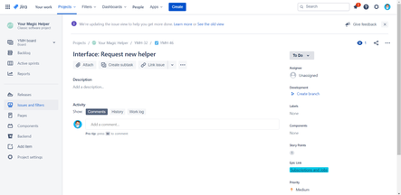

If I view the actual issue outside of the context of search results I get the new view, so the problem is entirely limited to the search results.
