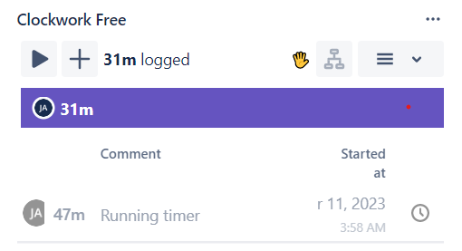

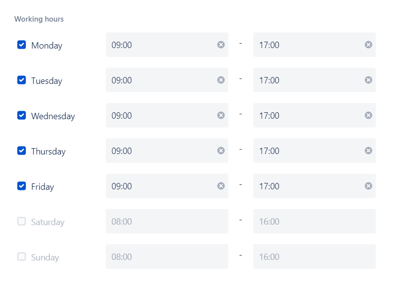

After specifying the working hours in clockwork settings, I still noticed that tickets still in progress that are outside the working hours are still tracking. I thought specifying the working hours will mean that any ticket in progress will stop tracking once they're past the working hours. @Pawel from HeroCoders I'm currently on the free plan. Thanks

Clockwork does not stop the automatic timers except the issue is transitioned to a non-active status.
This is because Clockwork recognizes that different users have different schedules and will assume the user’s normal start time based on the log entries and use the number of hours allowable in a workday (from the Working Hours) to detect overnight and over-the-weekend time. The overnight and over-the-weekend time will be subtracted from the total time logged to calculate the Time Spent. The total reported time will be split among days worked with one Jira Worklog entry for each day.
For example, If a user has working hours of 8-16 and start working at 10, we will count the time until 18, assuming they were 2 hours late but still need to work the whole 8 hours.
