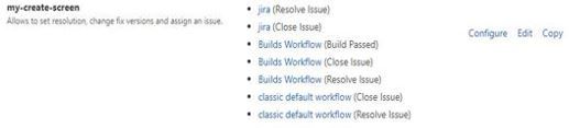

In the picture below I want to delete my-create-screen but it does not have a 'Delete' option on the right of the form.  How do I remove the workflow associated with my-create-screen so I can delete it?
ISSUE TYPES->Screens

To completely delete the screen you want, you will need to remove it from the three workflows it is added to and from all the workflow transitions. P.S: Note that these screens will not appear in the relevant workflow transition anymore once you delete it, so make sure you will not need it to fill any information in your issues.

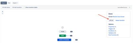

  2. Click to edit one of the workflows related to the screen (Check the screenshot you upload to know the name of the workflows). P.S: Notice they can be in the inactive tab
  3. Select Diagram
  4. Using the same screenshot you uploaded, check the name of the transitions that are added with the screen between brackets (Resolve issue, Close issue, etc)

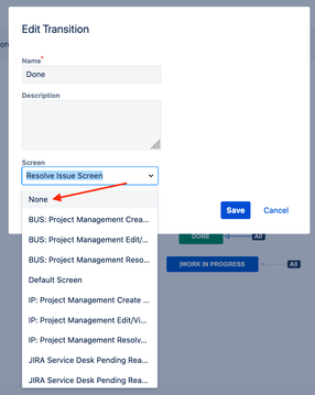

  5. Then, click to edit the transitions and remove the screen, by selecting "none" and Clicking save:
    Screen Shot 2020-06-30 at 22.00.35.pngScreen Shot 2020-06-30 at 22.00.48.png
