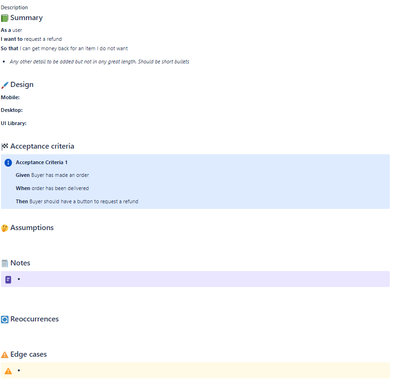

I've created a very useful Story description field layout for our Project that I'd like to use as a template across every new Story that is created. The plan was to create an automation that edited the Description field of a Story when it was created.

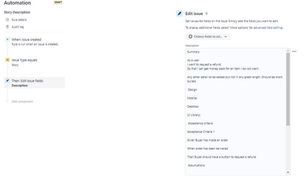

The problem is that when I try to paste the Story description field template into the automation process it only copies the text and none of the emoji's or info panels.

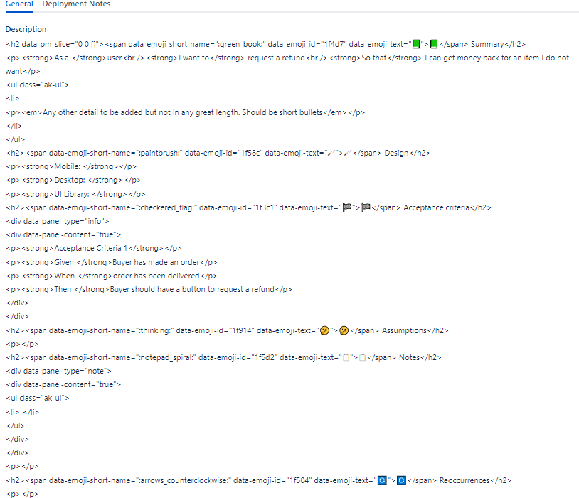

I've tried pasting the Story into an external site justpaste.it to grab the HTML and then paste this into the automation process but this just displays HTML in the description when the Story is created.

Is it possible to use Emoji's and Info panels in the automation process?
How do I go about adding this to the automation process?
