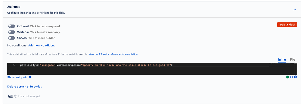

Does this sound correct.
def attachmentText = ‘………’
//getFieldByName(‘Attachment’) .setDescription(attachmentText)
Kristian Walker (Adaptavist)
November 16, 2023
Hi, MM6161,
This looks correct.

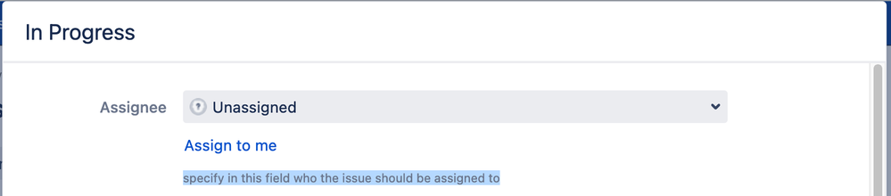

One thing I would advise is referring to fields by Id instead of name in scripts, as if you have 2 fields with the same name inside your instance this will cause the field not to be found.
I have just done a test adding a description to the assignee field to confirm this works on a transiton screen and can confirm it works as shown in the screenshots below.
