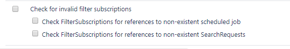

@Stephan van der Linde , not sure whether this will help but can you try to run Integrity checker (https://confluence.atlassian.com/adminjiraserver/using-the-database-integrity-checker-938847667.html) for the below checks?

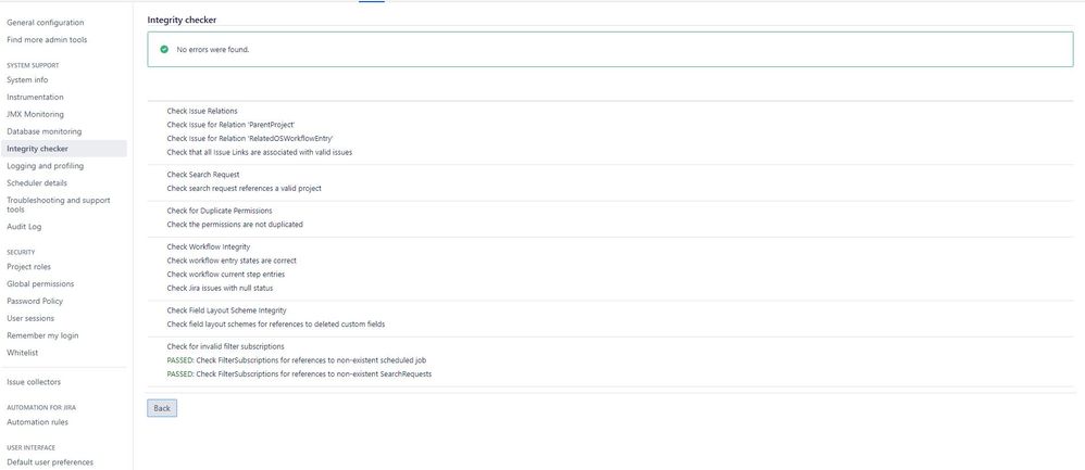

Stephan van der Linde June 4, 2019
Hi @Fazila Ashraf
Thanks for the reply, ran it and all checks passed:
