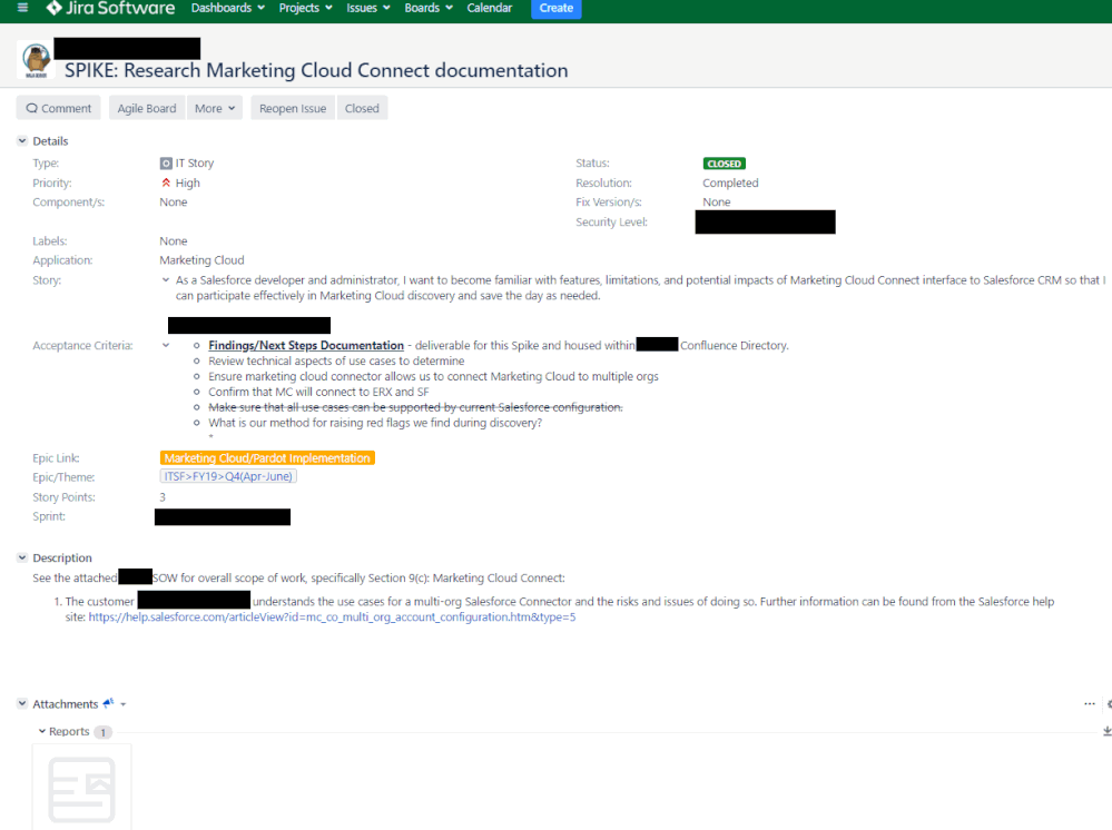

What we do is create a Spike for the exploratory work with specific Acceptance criteria that includes questions to be answered, and full documentation of future work based on the findings, written in Gherkin, either for the team to start working or possibly assigned to a different team.  Depending on the complexity of the work, the team can point it and start to build velocity.  This way you can also still get to "done" and track burndown over time.  The challenge is you may be adding more than you are working, but that half the fun.

For us, a Spike is just on the Story, but we name it Spike: to differentiate it from development or admin work.  We have also added a few custom fields (namely, Story to capture the use case and Acceptance Criteria for the questions and expected outputs) .  This way, we can query and report on these independently, vs trying to find specific text from the Description field.
I'm attaching a screenshot of one of our tickets so it may make more sense.Spike.gif
