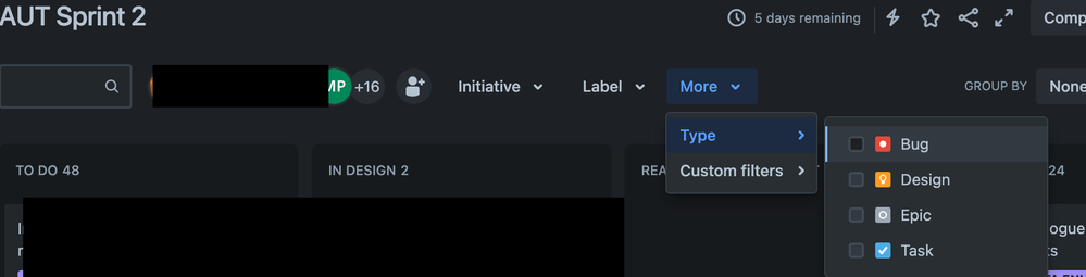

Your screenshots look like your project is a team-managed project.  The board for a TMP is fixed to a filter that is just "this project", but there are some configuration options for the board.
Go back to the board, and look for "manage custom filters" in the burger menu
You should be able to add many filters in there.
For sub-tasks, I'm quite fond of "issuetype in subtaskissuetypes()" and "issuetype in standardissuetypes()", and for your users, although I don't know which users you are looking for, "assignee = currentUser() or reporter = currentUser()" might be a good starting point.
The filters you add will appear in the "custom filters" dropdown.
