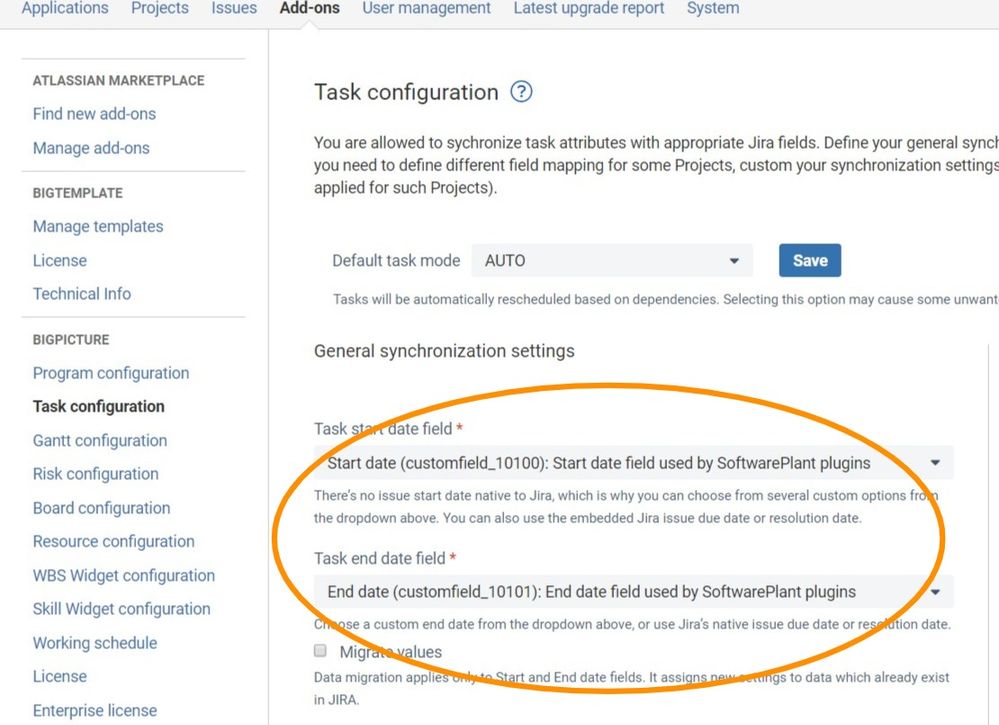

There are two things you should know.

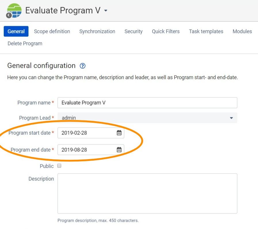

1) Program dates - those are independent of the Gantt's timeline. Consider these dates just an indicator.
2) The earliest and the latest task of a given Gantt define a timeline. By default there are "Start date" and "End date" fields which are taken into account.
The answer to your second question is YES. For example, you can map your custom fields to both Task start/end date fields in "Task configuration" section (see the screenshot above) and if moved a task on a timeline, your custom fields' value will get adjusted automatically.

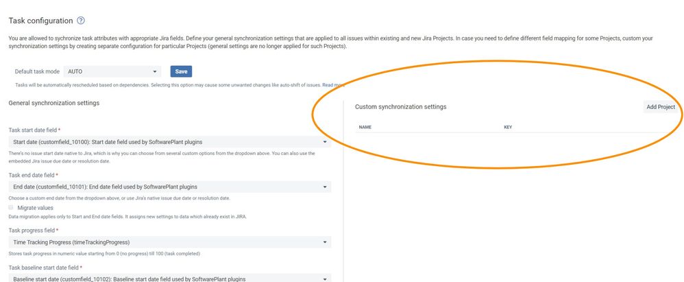

1. Well... I wish I could say you can define a task's duration (and thus a Gantt's timeline) with Story Points, but as for now it is impossible.

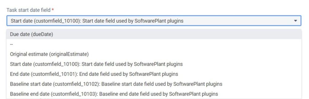

For task start/end dates you can use fields which are loaded by default (screenshot below), or you can use your own fields as long as they are Date Pickers.
The settings can be configured either globally or per particular Jira project.
So, assuming that each team has their own project, teams could use different fields for defining a timeline of their project.
