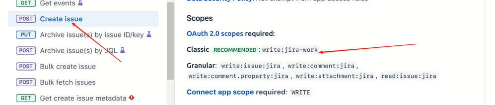

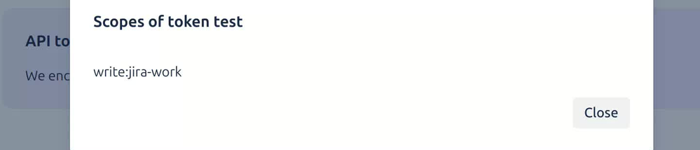

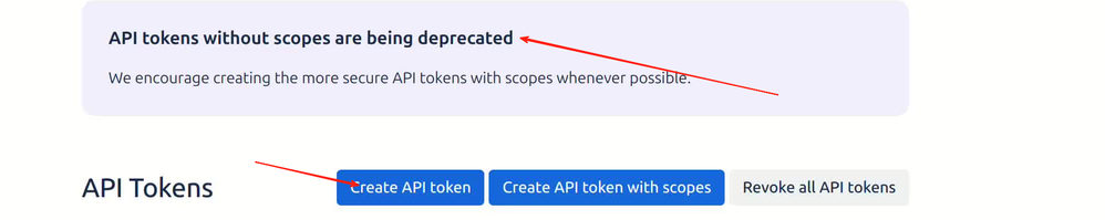

I used to create api token by clicking "Create API token" to create Jira issues and it has been working well for me .
But when I saw the notice, I tried switching to 'Create API token with scopes'. However, it didn’t work for me. I’ve already set all the required permissions as mentioned in the documentation

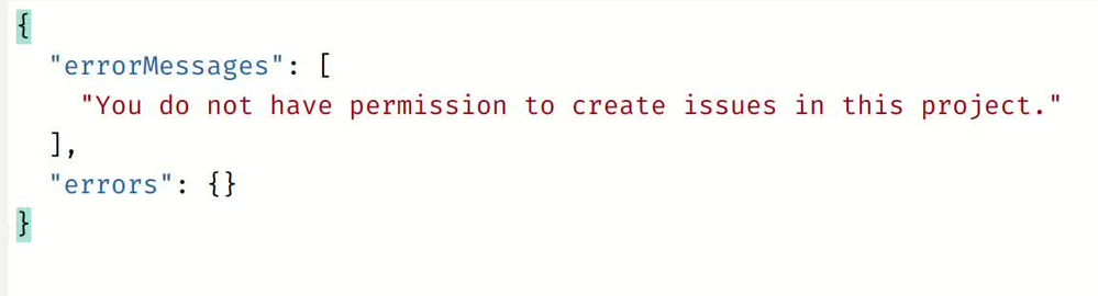

I just got the error message like
So what should I do to fix this ? @Mohanraj Thangamuthu
May 30, 2025
Hello, Good day. I would like to know if you are impacted with the following bug. https://jira.atlassian.com/browse/JRACLOUD-94545?
Let me know if your issue is different. Thanks
Longfei Huang June 2, 2025
Yes, thanks. That's exactly what I needed. I think the document should be updated promptly whenever the function changes, otherwise it will cause confusion.
