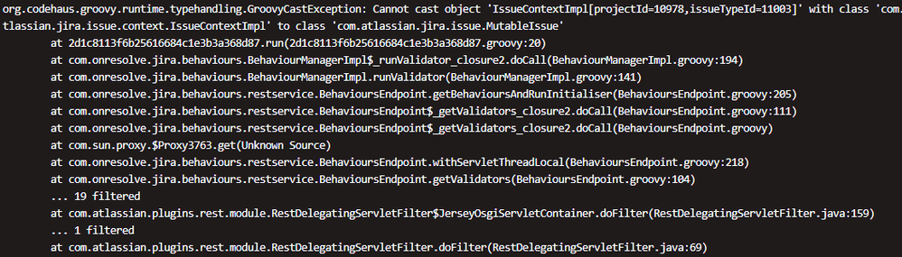

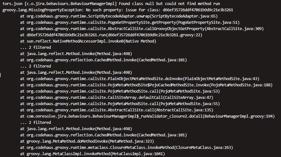

After I used your code to execute it, an error was reported. The error message is as follows:
Best regards.
Dear @jack ma ,

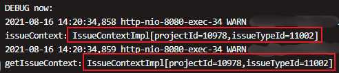

what scriptrunner version do you use?
In an behaviour, you get the current issue with the issueContext
Plz try, if it is empty or not?

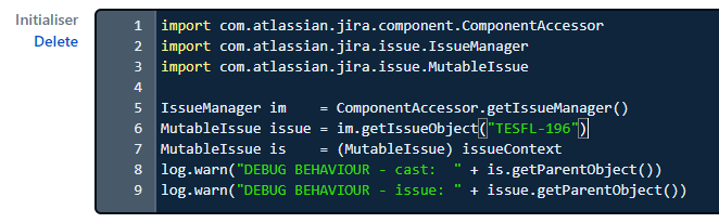

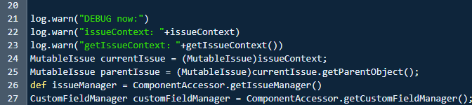

This works too (Full code, no import needed in a behaviour, initialiser!):
log.warn("DEBUG now:")
log.warn(issueContext)
log.warn(getIssueContext())
Source: How to get current issue object in Behaviour ? (atlassian.com)
How i did my example:
1. Created a behaviour
2. mapped it to my jira project and subtask
3. created an Initialiser
4. wrote my example.
If it doesn`t work, try out getFieldById(<Issue key field>) and then you can use the Issuemanager to get the issue like in my example above.

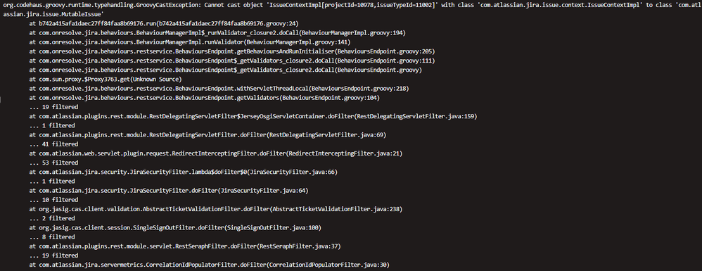

Hi@Fabian Laqua
The script version I use is 6.3.0-p5 Jira version is v8.0.2
I’m on the issue creation interface, and I haven’t finished creating it yet, I want to get the value of the parent task field when creating a child task. so I can’t use the getFieldById() method to get the value of issue key.
Thank you and Best Regards.
Dear @jack ma
now i understand your problem. There isnt a sub-issue yet. So you cannot cast to mutableIssue.
Why do you need the parent issue in the create mask?
Is there a special field you need to display or process?
If you need to display that data, then you can use a post function in the sub-taks-create transition to get that field.
Or do you need to recalculate something with this field in the create mask?
And that underlying wont work either in the create transition. I tried it out. But if you that sub-issue in edit the "underlying" works.
