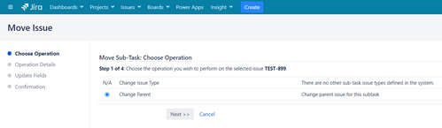

What you want to do is a 'Move' action of the subtask:
Maybe you should have a look at the Jira API to see if you can trigger this action from a script or something like that.
In the meantime, you should be able to do that manually from a subtask, or in bulk from the Issue Navigator, or even with a dedicated app (eg. https://marketplace.atlassian.com/apps/1211240/bulk-move-subtasks-for-jira).
But I'm sorry, I've no solution for now to automate this after a copy...
