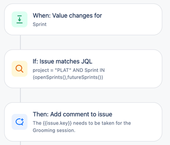

I am intending to set up a JIRA Automation to check if the Sprint of an issue has been updated for the currently running sprint or for the next upcoming sprint. Whenever an user does that, I'll add a comment or label so that those tickets can be picked for Grooming and Estimation ASAP. Can anyone suggest how to get the nextsprint name/id either through special value or JQL?

Hi @Bill Sheboy @Nikola Perisic Appreciate your response. Yes, I am explicitly looking for a JIRA Automation rule to implement so that even if it's missed a comment will be logged in the ticket comments.
I already tried the approach which @Nikola Perisic had suggested but the issue is if I have multiple upcoming sprints (futureSprints()), then it'll consider all of it. How ever, my purpose is to check if a ticket which has been marked for the next sprint should not have a blank / empty Original Estimations.

Nikola Perisic
February 23, 2025
Hello @shantanu behera
You can make something like this:
for project put your project key instead the one from the picture.
