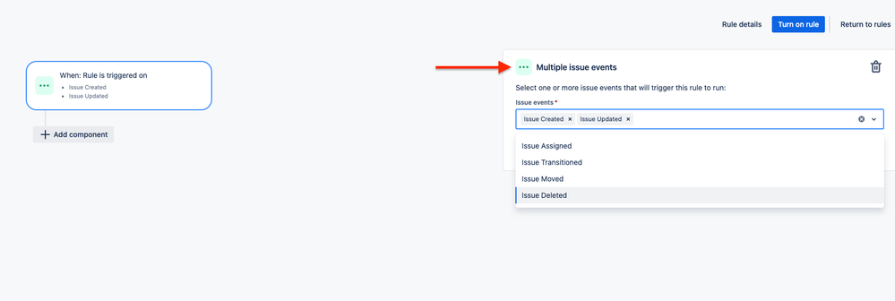

Hi @Roopa V
Yes, with the Multiple issue events trigger.
