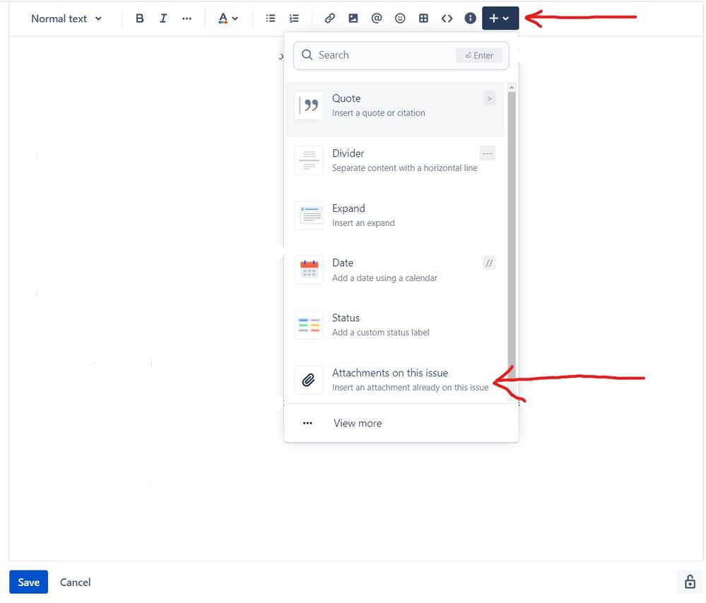

Alex Palma
September 6, 2023
Reading this in September 2023, it looks like there is now a GUI way to achieve this:

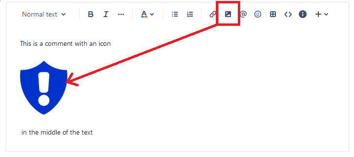

Hello @Dave Calkins
When you edit a comment in the new experience, a toolbar will appear at the top of the text area. Click the Files & Images button. The image will be attached to the issue, then be placed in the comment text at the point where you inserted it:Annotation 2021-03-29 181651.png

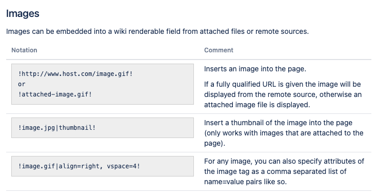

Mike Doolittle
November 4, 2021
Here's some documentation but, as you noted @pavelpigalov , it doesn't seem to work anymore: https://jira.atlassian.com/secure/WikiRendererHelpAction.jspa?section=images

Gunnar Hieronymus Hovden
September 8, 2022
This
!image.jpg|thumbnail!
still works if you first go to settings (three dots) and choose "See the old view". Once thumbnail is added it will show in "new view" also.

Matt Powers
September 18, 2024
Checking in with my current experience, with Jira cloud
"version": "1001.0.0-SNAPSHOT",
I can paste an image snapshot in an issue Description or Comment and then use my mouse to drag the sidebar next to the image to size it to a small version.  It works as a thumbnail image.  I didn't know the sidebar dragging was available as a way to get a small-sized thumbnail.
However, I don't see support for doing this for an existing image attachment in the issue.  The closest you can do is "Insert element / Attachments on this issue" and choose the "inline" or "card" format.  Both are very compact, but don't give you the thumbnail experience.
