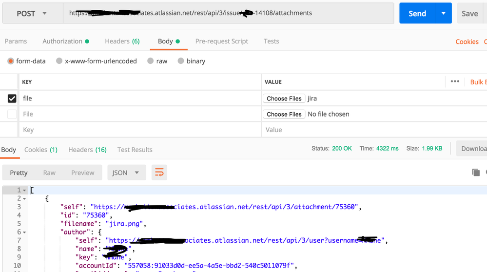

Nitin Mane October 23, 2018
Hi @Matthias Gaiser (K15t Software)
Thanks for your reply.
 My goal is create subtask, once subtask is created add attachment to it, attachment can be dynamic.
The postman works in the below format to upload an attachment.
set method type to POST.
Then select Body -> form-data -> Enter your parameter name
and on right side next to value column, there will be dropdown "text, file", select File. choose your image file and post it.
Is it possible to in key value format ?Screen Shot 2018-10-23 at 12.55.39 PM.png
Matthias Gaiser [K15t]
October 23, 2018
Hi @Nitin Mane,
What do you mean with key value format?
According to the Atlassian docs, you have to send the http request as a multipart/form-data request. And the name of the multipart/form-data parameter that contains the attachments must be file.
I don't think Postman has a more dynamic behaviour for that - but maybe someone else knows more.
Cheers,
Matthias.
Hi Matthias Gaiser
I meant how to achieve via RAW text or Json not in form data request, because the image which is uploaded is dynamic.The image and txt file is stored in my local.
October 23, 2018
I believe this is not possible. If you want to have a more dynamic behavior, you could script it outside of postman. But you still need to send the request as form data.
