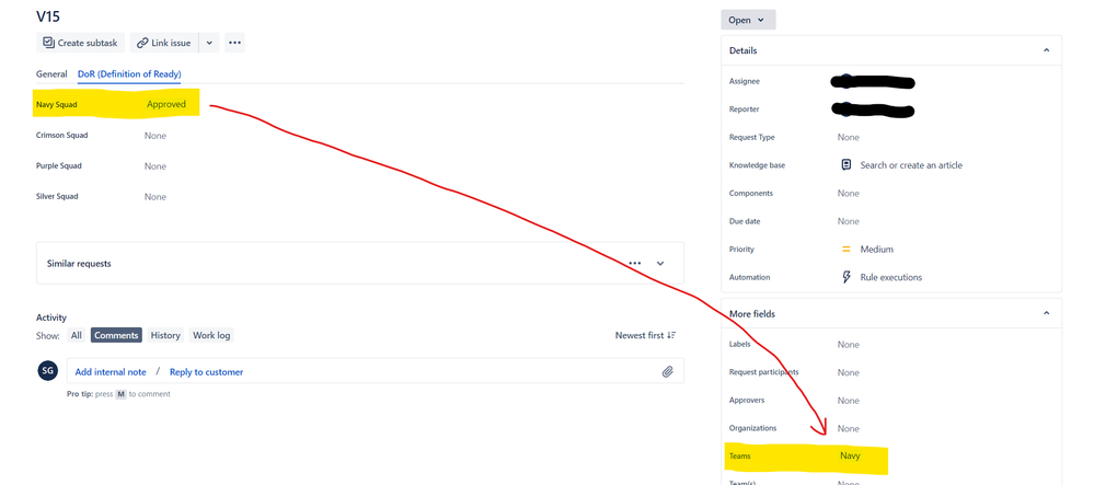

I have a specific task to do. I have to create an automation for multiple squads and when each squad chooses the option "approved", the squad name should appear in another field. I did it for one squad and it was working perfectly. See attached picture.

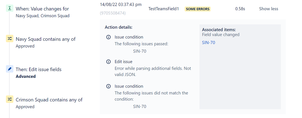

But when I tried to add another team, the first team name in the field was replaced with the second one instead of keeping both names. See attached picture.

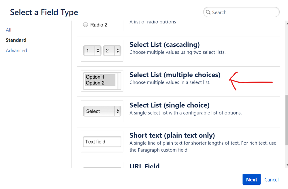

I was experimenting with different custom fields (currently I use the custom field "select list - multiple choices) but without success. Then I tried to experiment with advanced field editing with JSON. But I'm still new in Jira and not that experienced, so I need help. I found something that could work for my case but after many tries didn't work at all.

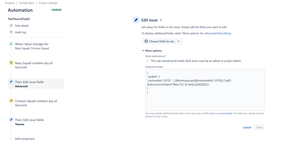

Also, you can see my automation here

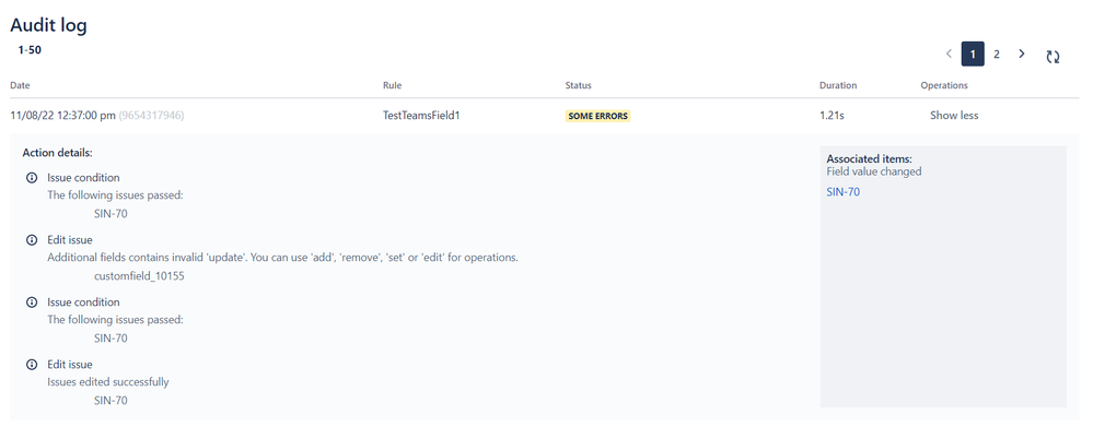

As well as my audit log error

Not sure why you would need to use #lookupIssues. What if you just did this:
"update": {
"customfield_10155": [{
"add": "Navy"
Hi John,
I really appreciate your suggestion. I've tried and it didn't work, unfortunately, here is the
audit log error
Ah, looks like I missed one more curly bracket at the very end when I cut and pasted. Ad one more } and a new last line or one beside the very last one and give that a whirl.
Like this maybe? didn't work either
