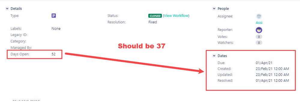

That worked to clear the error but it's still not showing the correct number of Days between open and closed. I changed status from "Reopen" to "In Progress" as that is the status that it would reopen to. (btw - thank you so much for the help!!)

@Beverly Braham-Durica would you please share the history of the issue, when exactly all the transitions were performed?
