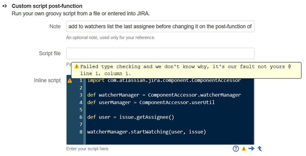

In a particular transition I change the assignee from developer to QA responsible, but would like to add the developer as watcher so he is still in the loop of his code.
I therefore would need a post function (script), that adds the previous assignee to the list of watchers.
Hoe can I do this?

As I understand, you want to add to watchers list the last assignee before changing it on the post-function of a transition, right?
Adding this script just before the "change assignee" step of the post-function and it should work:
def watcherManager = ComponentAccessor.watcherManager
def userManager = ComponentAccessor.userUtil
def user = issue.getAssignee()
watcherManager.startWatching(user, issue)
Hope it helps.

Peter Kocher May 8, 2018
Hi Marcos, I copy/pasted your suggested script, but it does not run. see attached JPG

Peter Kocher May 15, 2018
Hi Marcos
I found the error - I tested with a project, where the modified workflow was not assigned - too stupid !!
Your script works perfect.

Marcos Sanchez
May 8, 2018
It's not a script problem (as message says), so if you add it to the post-function and test it, it should work.

Peter Kocher May 9, 2018
I did what you told me and created a new (first) post function with the script. See attached screen shot. If not this way, how shall I add your script?

Marcos Sanchez
May 9, 2018
This configuration of the screenshot is fine.
I've just told you that the error that you get in the first screenshot is not a code error.
Did you tried to do the transtion and check if that all works?
Marcos
Peter Kocher May 10, 2018
Good morning Marcos
Yes, I added the script to the JIRA test instance and processed through the workflow. As you can see in my last screen shot, the post function says: "Has not run yet", so it did not process and I do not know why not.

Marcos Sanchez
May 10, 2018 edited
Is the workflow correctly published?
I know that this question can be obvious but is just for checking.
Marcos
Hi Marcos
Yes, the workflow is published. I re-tested, added myself as reporter and assignee, removed all watchers and processed the issue through the workflow. In the transition, where the assignee is changed, I am not added as watcher. And the post function still says: "Has not run yet", so somehow it does not start.
Best regards
Peter
