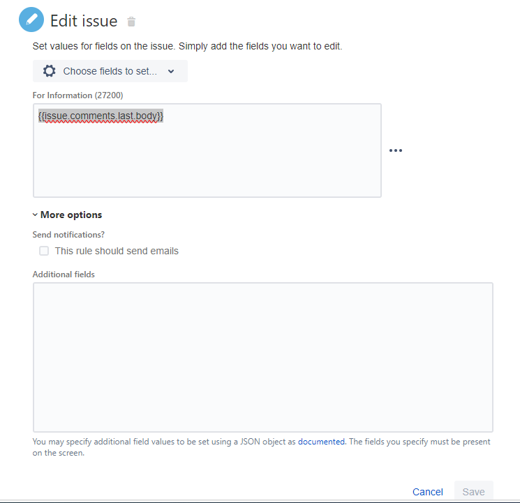

vincenzo_spatafora
October 18, 2024
Thanks @Marc - Devoteam.
Not sure I fully understand.
Do you mean from "Edit issue" to select my multi line text field and then to add {{issue.comments.last.body}} as for below:
Cheers, Vincenzo.
Marc - Devoteam
October 18, 2024
Hi @vincenzo_spatafora
Yes the Edit action and select the multiline field
But add :
{{issue.For Information}} or {{issue.customfield_27200}}
The first smart value is to retina the original content.
Check which smart value you need to retain the original field value the name or custom field ID
