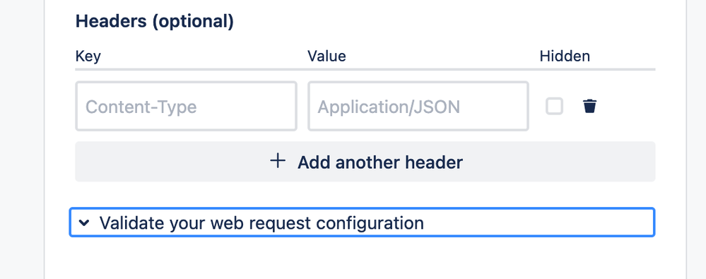

That depends on your API implementation. For example - in a very typical implementation - you can have your API to read in the authentication parameters from the request headers, and then input that in the web request form.
For example
Jamshaid
February 13, 2024
@Hariharan Iyer i can not find headers in webhook options
Hariharan Iyer
February 13, 2024
@Jamshaid , sorry to hear that. Just to confirm, are you looking at the web hook trigger, or the send web request action? The former is an incoming request for when to run an automation, while the latter is an outgoing request that can be run as part of an automation. Can you clarify which one you're interested in here as part of your workflow?
