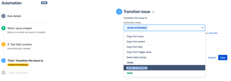

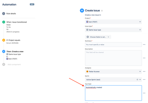

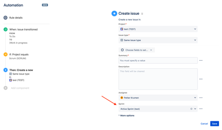

Per your description, I understand you want to automatically select the Sprint for the new issue created with the automation above and transition it to a specific status. Is that correct?
Since your rule will interact between two projects (A and B), you must create a Global rule to achieve your need. These would be the steps:
